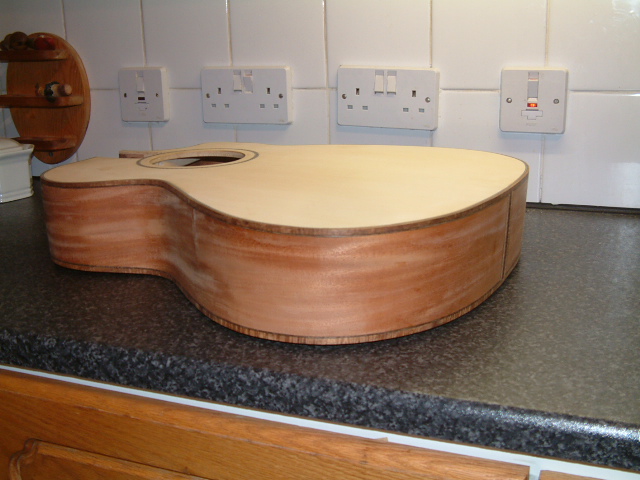

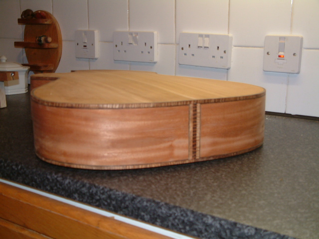

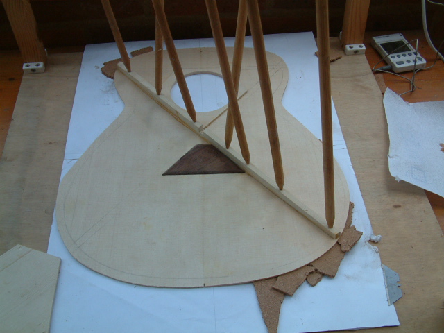

Not cylindrical. I put the arches on the bottom of the braces and glue them to the top and back in a go-bar deck using cork shims around the sides (I think I got this from Jim Williams book):
The top/back and braces then decid how they are going to equalise tension and settle into shape. These are the best pics I have of the sort of shape (I need to do some better ones):
